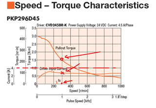

    3. Here's an example stepper datasheet Speed - Torque characteristics from a vendor along with winding current. https://catalog.orientalmotor.com/item/2-phase-bipolar-stepper-motors/shop-pkp-series-2-phase-bipolar-stepper-motors/pkp296d45aa. Based on the application need identify the desired pull-out torque and stepper speed. The current at this intersection should be the typical Ifs setting used for the application with this specific motor. This motor will generate up to 1.5 N-m with approximately 3A Ifs at 300 r/min speed of the motor. I hope this helps.

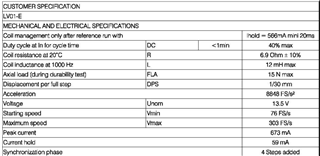

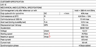

        For question3 do you mean,in this application we need1.5 N-m at 300r/min speed.So from this figure we can find the related current is 3A?And the '1.5 N-m' is just the maximum torque the motor can provide,which should be no less than the actual torque needed in the detail application.Right?
        And what happened if we only provide 2A or less?From this figure we can't found the related Speed-Torque characteristics.
       I have a datasheet on hand but there is no Speed-Torque characteristics provided.Can we design the 8889 just base on the information below?
  • Hi Zhiyuan,
    Yes that's correct. "And what happened if we only provide 2A or less? From this figure we can't found the related Speed-Torque characteristics.". The vendor did not provide that data, but we can say the maximum torque output will reduce as you reduce the full-scale current.
    Motor vendor should provide speed-torque characteristics. It also possible for customer to measure and do their own speed-torque characterization with suitable mechanical setup to measure torque. That said there is reasonable information in this table to design stepper motor driving for this motor using the DRV8889-Q1. The Vmin and Vmax voltage values are missing though. What are the application goals, operating parameters of the stepper for the customer application? What is the end application? Does the customer want to use stall detection feature? Does the customer have a DRV8889-Q1EVM?
