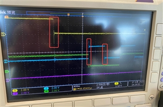

Ch1:cs
Ch2:clk
Ch3:miso,no data
Ch4:mosi
The operation corresponding to the waveform is read Configuration Register(0x07), The data sent by MCU is 0x4747
nSLEEP is tested as high level and VDD is 3.3v
Ch1:cs
Ch2:clk
Ch3:miso,no data
Ch4:mosi

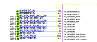

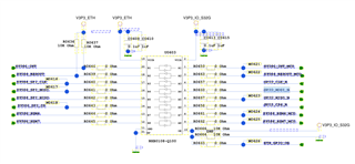

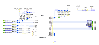

Hi Ryan,
Thanks for your reply.
This is the relevant schematic diagram,The communication pins of SPI are directly connected to the MCU terminal.
We tested two devices, and the results were the same. Do you see anything wrong with the schematic?
