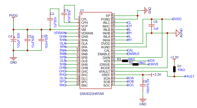

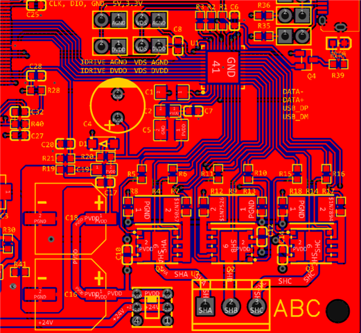

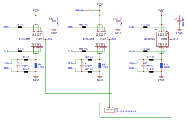

Hi team,
Here's an issue from the customer may need your help:
Customer uses DRV8323HRTAR proof to make brushless motor drive, layout is done in accordance with chip manual, drive is now working properly. But now there are two issues:
1) There is significant electromagnetic noise at use.
2) The sampling current is higher than expected.
Please see the schematic and layout:
Could you help check this case? Thanks.
