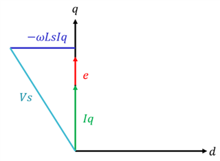

BLDC motor in motoring mode
Figure 2. Phasor diagram of BLDC motor in motoring mode
  • Considering the motor to be Surface mount permanent magnet synchronous motor (SMPMSM), phase current on d-axis (Id) is 0.
  • Phasor diagram in Figure 2 shows the motor in motoring mode. In this mode, the Motor driver drives the motor to generate mechanical energy. Phase current in q-axis that generates the motor torque is in alignment with the Back EMF (BEMF) voltage to generate maximum torque.
  • In motoring mode, the input electrical power Pin = Vd*Id + Vq*Iq  . Since Id = 0, Pin = Vq*Iq or e*Iq where e is the BEMF voltage and Iq is the phase current in q-axis. Output mechanical power generated by the motor is Pout = T*ω    where T is the torque and ω is the motor speed.
  • Ignoring the motor losses and resistance drop across Rs, torque generated by the motor, T = e*Iq/ω.

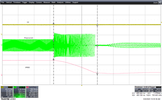

  • In this mode, the input electrical power Pin = -e*Iq which means the power will flow into the motor driver causing the DC bus voltage to overshoot.
Figure 4. DC bus voltage, phase current and motor speed in normal braking mode
Figure 4 shows the DC bus voltage in Yellow, phase current in Green and Motor speed in pink. In normal braking mode, when the motor decelerates from 100% speed to 20% speed, DC bus voltage overshoots from nominal voltage of 20V to 28.8V. Time taken for the motor to decelerate from 100% to 20% speed is 1.45 seconds.

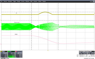

Figure 7.  DC bus voltage, phase current and motor speed in active braking mode
Figure 7 shows the DC bus voltage in Yellow, phase current in Green and Motor speed in pink. In active braking mode, when the motor decelerates from 100% speed to 20% speed, DC bus voltage does not overshoot. Time taken for the motor to decelerate from 100% to 20% speed is 1.38 seconds.
