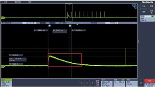

my customer is using DRV8873 and they found that the output current will be up to 30A for about 24ms.
Will this damage the chip? And what is the maximum transient current that the chip can tolerant? Thanks!

This device is only rated for a max 10A peak output drive current. So operating at 30A for 24ms can lead to driver damage. The OCP will trip if the current exceeds 10A for longer than 3us. Otherwise you might also run into a thermal shutdown. We only have information on the maximum output current and not on the transient current.

u can refer to below picture and the output current is shown as yellow.
After the braking, the current renewal time will be about 20ms. Do u have any advise on this case?

Could you explain the use scenario a little more? Is the customer spinning a motor and if so at what current and voltage? And then the brake is applied? Is the customer seeing any damage?
Also the image is very blurry, could you upload the image with higher resolution or put it in a PPT or zip?

The scenario is that the motor is short after the motor spins normally. They current is 2A and the voltage is 12V and then the brake is applied. They didn't see any damage.

Why is the the driver output shorted if you are going to brake the motor? Also the chance for driver damage exists if current higher than the abs max is applied at the outputs.
