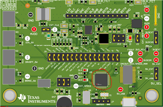

Then my powersuplly went to overload ( 4A) and see the picture.
Do you have any idear what went wrong?

  • Hi Andreas,
    From the image it looks like the cap C7 (0.1 uF PVDD cap) is damaged. This device is rated up to 60V. You mentioned that at 35V you stopped the motor. While stopping the motor, did you see the Dc bus voltage overshoot? Can you share the register configurations?
    Tried to clean up the black...but not sure if C7 is the problem?
    All wires are not exisiting?!

    I think I can't use the board any more?
    The current limit was at 3A but the wire look that it is disappeared?!
    And that while all was switched off! ( My Customer an I are confused!)
    A option would be order a second one - but not sure if that helps -:)

  • Hi Andreas,

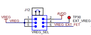

    Apologies for the delay. Do you also see the MSP430 (encircled in red in below image) damaged on the EVM? DO you see any puncture mark on the top case of the MSP430 IC?
    Vishnu
  • Hi Andreas,
    Please let us know if the latest response has addressed your question, or if you have further information to provide so that we can further debug. If your problem has been resolved, please help mark the thread as resolved.
    Thanks and Best Regards,
    Andrew
  • Hi, sorry for the delay...
    the MSP430 all looks fine... only the MCT is complete destroyed.
  • Andreas,
    The reason for this damage is because, the GCTRL voltage increases with PVDD as the source of the external FET is left floating. We would recommend either depopulating resistor R56 or moving the jumper from position 1-2 to position 5-6 (see below image for reference)
    Vishnu
