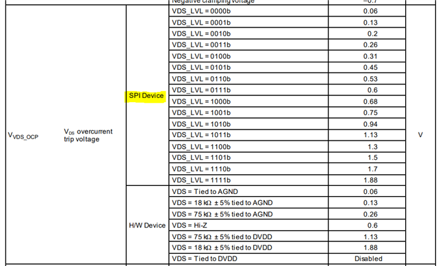

I_trip - %Amps // Max current for trip

    I_trip
    Please correct me if I am wrong, but I assume that this is referring to the VDS overcurrent trip voltage which depends on what you have this setting set to. The image below highlights the possible VDS trip voltages you can select via SPI.
