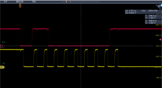

Customer is utilizing MCT8329A but cannot communicate with it at the first step.
They are using the MCU board to write I2C command to MCT8329's EEPROM: Start + targetID(110 0000)+ (0), but it fails to communicate at the 9th high signal of SCL, shown as,
I notice there is another thread in E2E of communication issue, shown here, https://e2e.ti.com/support/motor-drivers-group/motor-drivers/f/motor-drivers-forum/1215901/mct8329evm-i-couldn-t-start-communication/4616637?tisearch=e2e-sitesearch&keymatch=MCT8329#4616637
Not sure is there some address mismatch or some other issue? Pls kindly help on this.

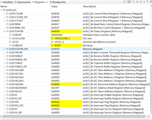

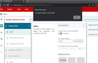

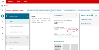

  • Hi Xiaoying,
    Yes, it's possible that there's a mismatch between the MCT8329's I2C target address and the GUI's configured I2C target address.
    I've just published a new MCT8329A GUI. In this new version 1.1.1, I've added a "Find Address" button in the I2C Controls side panel:
    Could you please instruct the customer to run this new MCT8329A GUI version 1.1.1, connect the EVM to PC, power-up the MCT8329 via PVDD, then click on the "Find Address" button? The GUI will automatically search through all possible I2C Target Address until it finds the correct address, at which point a pup-up dialog will indicate the found Target Address:

  • Hi Eric,
    But this error occurs in customer's own board, not the EVM. So seems that they cannot use the GUI?
    They are using other MCU board to communicate with MCT8329 directly but failed. Is there any way to find/read the right target ID? Or any other problem can cause this communication failure?
    Xiaoying

  • Hi Xiaoying,
    I can't think of any other possible schematic related issues that could cause the MCT8329 to not respond to I2C command.
    One thing I noticed in the waveform captured above is the MCU doesn't seem to implement clock stretching to allow the MCT8329 time to respond with ACK. Could you please ask if the customer can implement clock stretching?

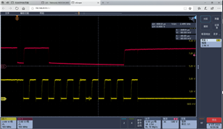

  • Hi Eric,
    Thank you for your help. This question was asked by Xiaoying for me

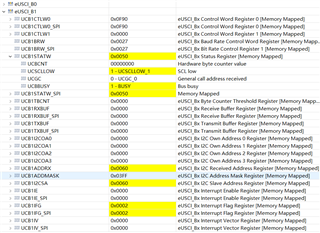

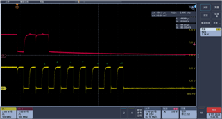

    The latest test results are as follows
    The mcu board is MSP430FR2355 LaunchPad
    The project is “8867.HardwareI2C_MSP430FR2355_MCF8316AEVM”
    I only changed the SLAVE_ADDR from 0x01 to 0x60, and INTER_BYTE_DELAY from 5600 to 700
    1.use MSP430FR2355 LaunchPad to communicate with MCT8329A,
    after EUSCI_B_I2C_masterSendStart(EUSCI_I2C_BASE); excuted,
    The register status is as follows
    And the waveform is as follows

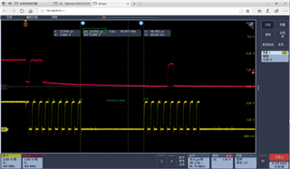

    2.use MSP430FR2355 LaunchPad to communicate with F280025 LaunchPad,
    F280025 was configure as slave, and set its address 0x60
    The complete starting byte and the first data byte 0x10 waveform are as follows, and it can be seen, about 25 us delay was insert between the starting byte and its ack,
    can the results indicate the “clock stretching” has been implemented in “8867.HardwareI2C_MSP430FR2355_MCF8316AEVM” ?
    and Can this indicate that MSP430 LaunchPad has already worked as 8329a expected ?
