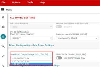

In the MCT8329EVM GUI, there is a setting of LDO=5.0V as shown in the image below. As far as I can see in the datasheet, the LDO is 3.3V and I can't find the SEL_LDO_5V register itself.
Is it possible to set LDO=5.0V with MCT8329A?
Q2
I would like to know the contents and settings of Analog_Trim in the image below on the MCT8329EVM GUI. I couldn't find a detailed explanation in the datasheet.

    • Q1: The SEL_LDO_5V bit is supposed to be reserved as shown in the datasheet, and this is a mistake in the GUI's register map config. Setting this bit in the GUI will not have any effect on the 3.3V LDO output. We will update the GUI and publish a newer version with the bitfield and widget removed.
    • Q2: The Analog_Trim registers are internal trim registers programmed in factory that are not exposed to users. Please note that these registers are also not writable by the user even through the GUI. The GUI will also be updated such that these registers will be read-only in the register map view.
    I didn't understand this sentence. As far as I can see in the datasheet, there is no "SEL_LDO_5V" register.

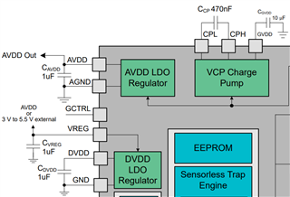

    Which block diagram does this 5V or 3.3V LDO show?
  • Hi Conor,
    Apologies for the confusion. The SEL_LDO_5V bit being reserved means that it won't show up in the datasheet. It was a legacy bit that got mistakenly included in the GUI during development.
    The MCT8329A only has a fixed 3.3V AVDD LDO Regulator and a fixed 1.5V DVDD LDO Regulator.
    3.3V AVDD is directly sourced from PVDD, and cannot be selected to a different voltage.
    1.5V DVDD is sourced from the VREG input pin, which has 3 connection options:
    • AVDD powered VREG
    • External 3V ~ 5.5V supply for VREG
    • External MOSFET for VREG
    Please refer to the datasheet section 7.3.4 for more details.
