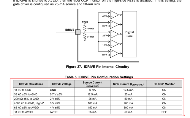

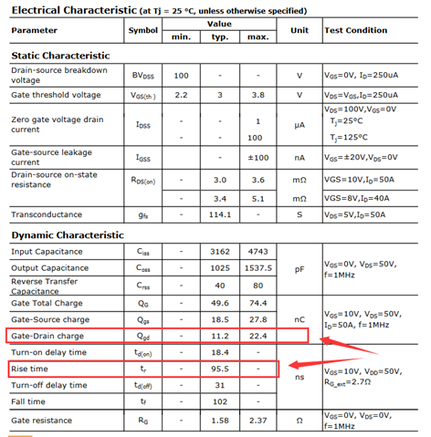

How is IDRIVE selected? According to the data sheet, it is hard to apply on many devices:
If the following MOS exceeds these values, will it not be driven?
Could you help check this case? Thanks.

Cherry,
For the first question, customer can ignore the "rise time" spec in MOS datasheet. I am not sure why that is there. The Qgd is important specification and they need to decide how quickly they want to drive the FET by using equations in the datasheet to calculate Idrive depending on desired rise/fall time they want.

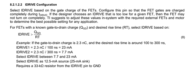

What exactly is this calculation here? What exactly does the drive current flow for IDRIVE get? Could you help give an example?

Cherry,
An example calculation is given in the first post on this chain. Section 8.2.1.2.2 of the datasheet. There shouldn't be any confusion. Customer should know desired slew rate and calculate Idrive based on their FET.
