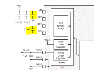

    What is your IDRIVE set to? It could be the case that your IDRIVE setting is too large. Also what are the capacitors that you are using for the charge pump?

    I have used 1uF capacitor X5R 50V (part number CL10A105KB8NNNC) for Bulk capacitor , only change from the above values is that the 10UF between Vm and GND is not used but a 4.7uF is used which I am planning to replace .

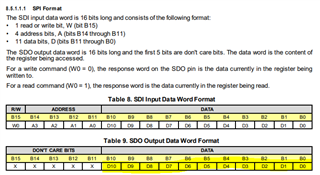

    One thing you can notice is GATE_DRV_LS register is zero even after writing some values , I am currently testing 1x PWM to test hardware and later on we will be switching to 3xPWM . Can You please tell me why GATE DRIVE LS is zero even after writing  some values (11 bit , even defalut value is non zero)?
  • looks like my SPI read/write is not proper :( .

    Could you please describe what is going on in more detail (is the SPI register not being correctly accessed, etc.), this will help to narrow down where the issue could be occurring? Are you able to share waveforms (from a logic analyzer) of the SPI reads and writes that you are doing?

  • Hi Alicia,
    Sorry Alicia , I forgot to update the SPI mode , realised it was SPI mode 1 not SPI mode 0
    these are the default vales (only two registers are not matching the datasheet)
    yes all values are decimal

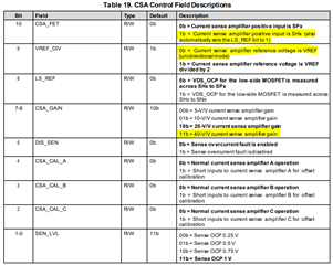

    ADR_CSA_CTRL = 3267 ----> not matching the default value (643) !
    ADR_CSA_CTRL = 3267  ----> not matching the default value !
    only this register is now having a different value after strartup , can you please suggest why this might be happening?
    Converting 3267 to binary you would get (1100 1100 0011)2 which is a total of 12 data bits which I am curious as to what the MSB would be as there should only be 11 data bits, as specified below:
    Aside from that, ignoring the MSB which would give us (100 1100 0011)2 or 1219 in decimal, it appears that the highlighted bits below are different from the default:
    From what was mentioned previously,
    I am using a 5mOhm current sense resistor with 40V/V setting
    Would it be possible that you are writing to this register which may be the reason why it is not at the default value?
