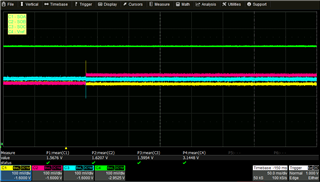

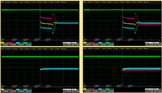

  • Joshua,
    See the images below. As before, below are the labels for each waveform:
    Yellow: SOA (stays the same)
    Red: SOB (shifts in level)
    Blue: SOC (stays the same)
    Green: Vref (3.15V, where we're using Vref/2)
    The transition here is when Enable goes from OFF to ON. (Vref is already up, as you can see)
    The top two images are zoomed at 50us divisions. Here we see (what must be) the auto-cal routine trimming the offset. You'll see that in this case, from one instance to another (same sample, done a few minutes apart), the offset for phase B is lower than the other.
    The lower two images are for the same sample, at 20ms divisions.

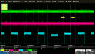

  • Joshua,
    More data - as before, labels are the same (same sample).
    Here we're manually triggering the auto-cal (for all 3 phases) while DRV is enabled. The same step in offset is observed for phase B.

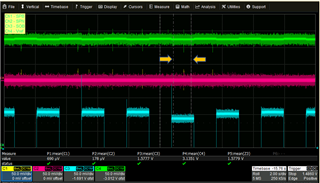

  • Joshua,
    More data, last for today. As before, labels are the same (same sample).
    This is when the manual auto-cal is turned OFF. The datasheet indicates that the gain changes to max setting when auto-cal is run, and that is must be why we see a change here, although it doesn't appear to be consistent for each phase.
    Is it possible the auto-cal routine doesn't adjust the gain correctly every time?

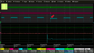

  • Joshua,

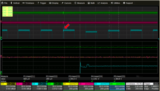

    See below. These are Enable cycles, so auto-cal happens on each one. We are using the default Gain = 20V/V.
    Yellow: SPB (CH1)
    Red: SNB (CH2)
    Blue: SOB (CH3)
    Green: Vref (where we're using Vref/2)
    1st Image: Cycle before offset change - top plot shows collected data, with bottom plot zoomed in on the area indicated by red arrow.
    2nd Image: Cycle showing offset change - top plot shows collected data, with bottom plot zoomed in on the area indicated by red arrow.
    3rd Image: Cycle after offset change (appears to return to higher value) - top plot shows collected data, with bottom plot zoomed in on the area indicated by red arrow. Note - for each plot, the "measured" mean values come from the range indicated by the orange arrows.

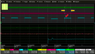

  • Joshua,
    These are similar scope captures, but without zooms. The Measured values are now from ranges inside each enable cycle (orange arrows).
    Yellow: SPB (CH1)
    Red: SNB (CH2)
    Blue: SOB (CH3)

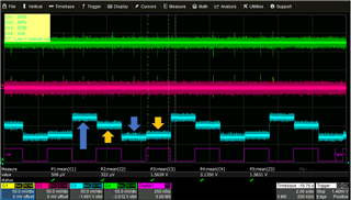

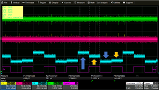

  • Joshua,
    See below. These are Manual Auto-cal cycles. Here we see the SOB output alternates settling in at the higher value and the lower value. Blue arrows indicate where atuo-cal is enabled (Digital1 is low). Orange arrows indicate when auto-cal is not enabled (Digital1 is high).
    Yellow: SPB (CH1)
    Red: SNB (CH2)
    Blue: SOB (CH3)
    1st Image: measured mean values for SOB at higher value (range at 1st orange arrow)
    2nd Image: measured mean values for SOB at lower value (range at 2nd orange arrow)
  • Hi John,
    After looking at the captures you provided the input offset error that we calculated was within the devices specification of +/- 3mV. It is possible for the input offset error to be different per-phase and for the error to change every time the device is powered up.
    That said, we would like to determine if the noise on the input signals is causing any issues. Could you short the input signals as close to pins as possible and capture SPx, SOx and Vref?
    Could you also provide your schematic and shunt resistor value?
    Joshua

  • Hi John,
    Any feedback regarding the operation of the auto-cal routine?
    Based on the captures and information we have seen we do not believe that the auto-cal routine is the reason that there is a difference in the offset per phase.
    We're obviously seeing behavior that isn't expected in the shifting of the SOx level.
    We believe that the shifting in the SOx level is expected, The input offset error will cause the output to shift by +/- 3mV. From the mean measurements in the captures that were provided we determined that the error of the shift was within datasheet specifications.
    How would noise on the input signal cause these things?
    We wanted to make sure that there was nothing on the inputs that could have been amplified and contributing to the offset.
    How does the input offset error relate to these things?
    Input offset error results in a corresponding error on the CSAs outputs and the calibration does not perfectly remove the offset error resulting in the +/-3mV offset error specification in the datasheet that is being seen.
    What about the Gain - could this not be getting set correctly internally before/during/after auto-cal? Has this been considered?
    The device will set the gain of the CSA to the max, considering that the input offset is within datasheet specifications, this does not seem to be an issue.
    Joshua
  • Joshua,
    To summarize: A shift in the output like what we've shown (10x of mV) is expected and the auto-cal routine can't completely remove it.
    So, is the output offset error equal to the gain multiplied by the input offset error? I ask this because the datasheet doesn't spec the output offset error (just the input offset error of +/-3mV). If this is the case - then the "being within specifications" argument makes more sense. Because at 20V/V, that would imply an output offset range error of +/-60mV.  Figure 43 (below) seems to allude to this VSO offset being related to the input offset, but no additional detail is provided.
  • Hi John,
    Correct, the input offset error will be amplified by the gain leading to a greater offset seen at the output.
    Joshua
