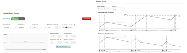

customer use our EVM, Test with a 12V 120 ohm motor.
GUI configuration is as follows:

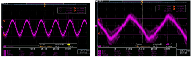

The measured waveforms are as follows, with significant periodic clutter that cannot be removed regardless of the adjustment of attenuation. And the noise of Ifs=40mA is greater than the noise of Ifs=70mA.
(1) What is the reason for this?
(2) How to remove?
