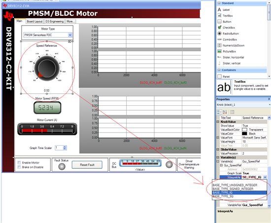

  • Hello Chris,
    thank you very much for all explanations.
    Does this mean that with the new GUI i can work with lower voltage? or it still recognizes my kit as DRV8312 and sets the limit for voltage?
    Another thing i noticed (after i finally downloaded the program with your kind help), that the minimum poles allowed at the GUI is 4poles.
    This is the parameter that actually participates in scaling PU for motor speed. Our motor is only 1 pole motor, so i guess mu calculations will be wrong.
    Am i right?

  • yulya,
    apparently I am confused and the PVDD (DC-BUS) is fine down below 5 volts.  However, the GUI for the 8312 is set to only work with 24V (it will trip with over or under).
    You could use the 8301, however note that the sensing for the voltage and current are all scaled to a certain range (60V, 82.5A), so with a small low voltage / low current motor the digitization of those small signals over a large range, digitized into 12b will give pretty poor resolution.  You would be better off re-working the sense circuits to scale between your maxes.
    1 pole pair, right? 1 pole would be an interesting control challenge :)
  • 8301 is 8 to 60 (charge pump)
    8312 is 0 to 52 with +12V gate drive supply
  • 3157.Modified8312.zipYuyla,
    I attached a modified GUI for the 8312 Insta-Spin.  Go to the settings tab and change the Min Voltage to 400. I also put in a option under poles for 1 pole. You can give this a try, hopefully it works.
    LT

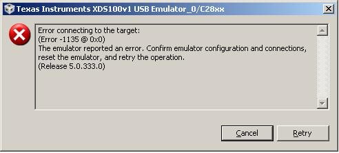

  • Hi yulay dikalov,
    was your effort successful?
    Yesterday  I unpacked my DRV8312EVM Low voltage BLDC Kit. I conneced it to the USB socked and opened the GUI out from Control Suite "DRV8312GUIv2.exe".
    The connection established and the Motor was spinning.
    After that I wanted to try the "InstaSPIN-BLDC_GUI_DRV83xx_v100.exe"
    I started composer studio, closed all my current projects (normally I'm working with TMDS2MTRPFCKIT) and tryed to flash the "InstaSPIN-BLDC_GUI_DRV8312_v100.out" file.
    After trying to connect to the target I was getting the following Error Code:
    Trying to connect to the XDS100v2 target result to the same Error.
    After installing the FTDI driver from the USB stick that is shipped with the DRV8312 Kit , no change at all.
    Normally I can work with the F28035 ControlCards, but maybe there is something special with the Isolated F28035 Card that is shipped with the DRV8312EVM kit.
    Do you know some special tricks to flash the Card.
    Have you ever tried to reprogramm the ISO ControlCard that was shipped with the DRV8312 Kit?
    Thanks in advance and regards,
    Roland
  • Roland,
    The Isolation card must be plugged into the powered baseboard in order to program. Also SW3 must have the switchin to the ON postion which is down. under TI\controlSUITE\development_kits\DRV8312-C2-KIT_v123\~Docs the DRV8312-C2-KIT_HowToRunGuide.pdf tells you how to set up the connect to flash the card. You should be using XDS100v1
    LT
  • Dear Thomas,
     thats it!
    Just switching the SW3 Switch to off while programming. Putting back the switch to off after programming and doing a ControlCard-Reset.
    Now the "InstaSPIN-BLDC_GUI_DRV83xx_v100.exe" GUI is working.
    Great!
