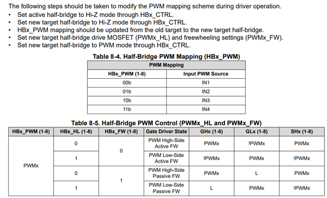

1. This chip driver can control 8 half-bridges (4 H-bridges) and can also be used as a high-edge driver. Can the functions of both H-bridge control and high-edge pre-drive be realized at the same time? (If so, can you provide corresponding application cases?)
2. Do IN1 to IN4 control feet correspond only to HB1 to HB4 channels?Such as IN1 to HB2?
3. Is there a priority relationship between IN1~IN4 control pin and SPI control?
  • Hi Ning, please see my comments below.
    1) This chip driver can control 8 half-bridges (4 H-bridges) and can also be used as a high-edge driver. Can the functions of both H-bridge control and high-edge pre-drive be realized at the same time? (If so, can you provide corresponding application cases?)
    DRV871x-Q1 can be used to control individual HS loads by leaving the unused GHx driver of the HB disconnected. There should be no issues to have some loads connected as HB and some as just HS/LS, as long as they are connected to the correct loads (example - if 2 channels are used to drive a full bridge, both of those must be used as half bridges). More details in section 8.3.3 of the datasheet, Figure 8-5 shows an example of this use case.
    2) Do IN1 to IN4 control feet correspond only to HB1 to HB4 channels?Such as IN1 to HB2?
    Our PWM mapping allows us to have 4 inputs for 8 channels through a combination of PWM multiplexers and SPI register settings. Each input INx can be mapped to multiple HBx, more details in Section 8.3.3.1.1 and Tables 8-4 / 8-5.
    3) Is there a priority relationship between IN1~IN4 control pin and SPI control?
    See question 2, both INx PWM inputs and SPI registers work together to map any INx to any HBx
