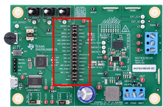

I will start evaluation of MCF8315 with the EVM Board. From the documents I found I saw there is a msp430fr2355 uC on the EVM doing the translation of "UART" Protocol to the MCF8315. Is a description or the Protocol from GUI to the EVM over Uart available? I would like to use my own simple gui to command the EVM...
Beste Regards,
Andreas
  • in particular can I and how can I control the PWM value controlling the speed when J1 is set to PWM.
  • Hi Andreas,
    Thanks for your question on the motor drives E2E forum.
    On the EVM there is an onboard FTDI chip taking USB communication and translating it to UART for the on board MSP430 to take in the signals. From there the MSP430 translates the UART signals and send them as I2C signals to the device. The best way to control the MCF8315 device without the GUI is to interrupt the I2C lines with your own signals using a microcontroller attached to the I2C bridge in the center of the EVM:

  • Hi Andreas,
    Just saw your second question, let me look further into that and get back to you by the end of the week.
    Robert
  • Hi Andreas,
    You can control the speed through PWM using the SPEED pin in the MCF8315A also located on that communication bridge:
    Please review the datasheet for more information on the SPEED pin.

  • Hi Andreas,
    To add to Robert's response, on the MCF8315EVM, the potentiometer is also routed to the MSP430FR2355, which uses an ADC to sample the voltage and generate a PWM with varying duty cycle depending on the potentiometer voltage.
    Therefore, when the jumper J1 is configured to PWM, you can simply use the potentiometer to control the duty cycle of the PWM generated by the MSP430.
