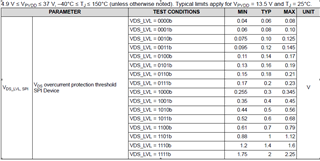

I have some questions from our customer for VDS_LVL deviation in DRV8714-Q1 datasheet:
1. Is there correlation between VDS_LVL and V_PVDD/Tj?
2. Could you provide the VDS_LVL-V_PVDD plot and VDS_LVL-Tj plot?
 Customer is concerned that by their estimation the overcurrent range is min30A~max170A over VDS_LVL and MOSFET rdson deviation, which is not a practical range in customer's usecase.
