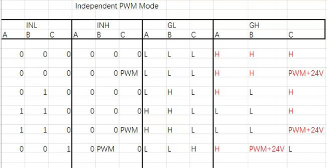

After powering on the 8353S, when both INLx and INHx are low, GHx and SHx are high.
Please help check it.
