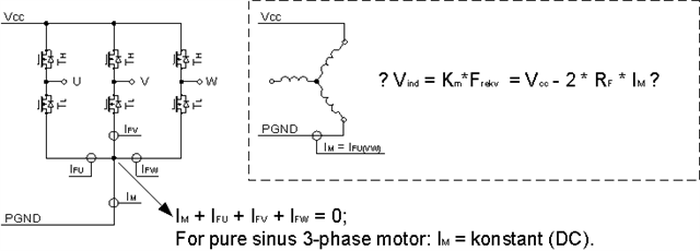

  • Here is a follow-up question on current measurement. The question is, what is the value of the phase current, i.e. the reading, in register 0x04?
    I am attach ing pictures for better illustration:
    Block diagram of the power stage connection.
    My thoughts on the formula for creating an engine model:
  •   <-Thoughts
    1) Where the current is measured, the value of which is stored in register 0x04. In my opinion, this could be where the IM current is measured.
    2) If the current is measured in the winding position, see the figure. Then the above equation could apply, right?
    (For the sake of simplicity, the influence of the winding inductance, which is very small in our motor, is not included here. Resp. the influence of the phase shift between the phase current and the phase voltage on the winding.)
    3) If the current is measured at the moment when the winding is in the indicated position, then the current IM is equal to the current IF of the phase that is currently connected to the PGND potential.

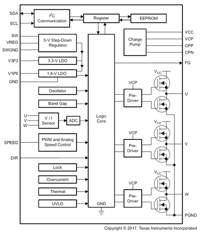

  • Michaela,
    Phase current in DRV10987 is measured internally using a current mirror circuit. This circuit measures the current flowing through the low side and high side FETs in phase U. Values readback from 0x04 is the peak value of phase U current.
    Vishnu
  • Hello Vishnu, can you please confirm this statement?
    From the answer, I conclude that the current is measured in the "U" phase branch, and that for both FET transistors.
    Since this is the maximum value of the current, the current measurement of the phase "U" for the "upper FET" should take place at the moment when the phase "U" is connected to the voltage Vcc and at the same time the phases "V" and "W" are connected to neutral potential of PGND.
    Similarly, i.e. mirror-like, the measurement of the phase "U" current for the "bottom FET" should take place at the moment when the phase "U" is connected to the zero potential of PGND and at the same time the phases "V" and "W" are connected to the voltage Vcc.

  • Michaela,
    DRV10987 uses 180 degree sinusoidal commutation technique to switch the FETs. I'm assuming you are referring to DC bus current as the "maximum value". Please note that the value read back from the current register is not maximum current or DC bus current. It is the current flowing through phase U. In this commutation method, DC current will split through any two phases so the phase current U is not the DC current.
    Vishnu
