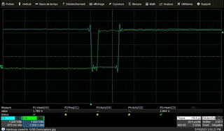

    see timing diagram with Enable reset pulse in blue and nFault in green.
    May be moisture rate, as it reaches 80% and sometimes more than 90%, can be a factor to increase leakage current. Although board has a conformal coating, connector pins and through hole capacitors are not recovered and so not protected.

  • Hello Alexandre,
    To clarify, are you using the SPI or hardware version of the DRV8323? If you are using SPI and set the PWM too fast (under 1 ms after enable is triggered) then that may be the issue. Also, how long is nFAULT low for and would you mind showing me waveforms for INHx and INLx during this period as well if the above doesn't work?

  • Hello Eli,
    We use the DRV8323RS, with SPI.
    nFault is erased after an enable reset pulse. But is set again after each restart of the board.
    For another type of application, we have thousands of boards working for more than a year without this issue.
    And for the application with this issue, 10% of the boards run out of service after 5-6 monthes.
    Can the timing really be the cause?
    We'll try to show you the waveforms.

  • Hello Alexandre,
    Would you be able to show me the layout you've been using for this? Also, are you hitting close to any of the extremes for the operating conditions listed in the datasheet?
