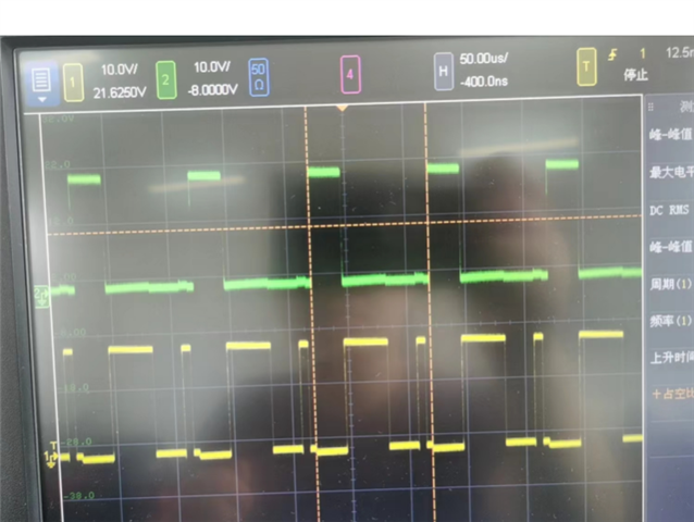

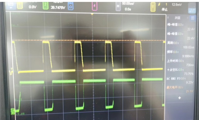

5) Below is the measured waveforms, could you help review is there any issues?
At normal operation
At stall
    What are the waveforms showing? Is it output voltage?
