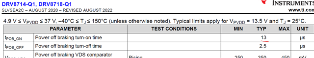

My customer is using the DRV8718S and he had a question regarding the motor braking feature of this IC. This IC’s datasheet states a Power Off braking turn-on time of 13us.
Is this a very accurate time? Are there any design considerations to not exceed this value? This datasheet only lists the typical value; what are the minimum and maximum values for this turn-on time? The OEM is requesting this information and I need to put it in Worst-Case Circuit Analysis.
