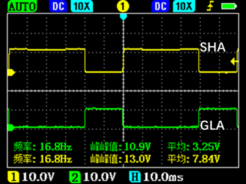

DRV8305-phase A input pin signal
DRV8305-Phase A Output Pin (Motor not connected)
DRV8305-Phase A output pins and some zoomed-in view (connecting motor)

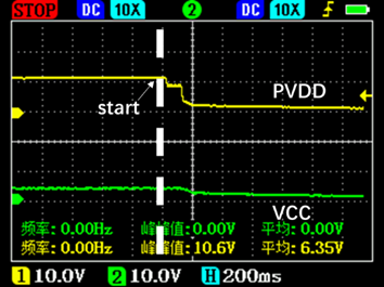

DRV8305-Phase A Voltage Measurement (Channel 1) with Motor connected
DRV8305-operating voltage PVDD (was 12v, but buck to 4.3V) and Vcc (connected to motor)

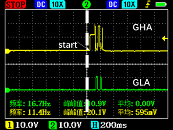

    The 12V adjustable power supply is provided above and the driver board drops to 4.3V during operation, which is not the normal operating range. The motor drive board was originally powered from a 12V (error 1V) battery and converted to 3.3V by an LDO chip.
    The following details are based on the 12v battery powered, six-step control method:
    With the motor unconnected, the voltage at which the drive board is operating is shown in the figure below.
    It can be seen that the outputs of GHA, GLA, and SHA are good.
    When the motor is connected, the drive board stops working for no more than 0.3 s, the outputs of GHA, GLA, and SHA are shown below:
    PVDD = 12v, Vcc = 3.3V before the driver board is not working.
    However, the failure occurs and stops in less than 0.2 s after the start of operation, and PVDD and Vcc have changed, as shown in the figure below:
    The entire drive board does not work and the voltage at PVDD and VCC are as follows:

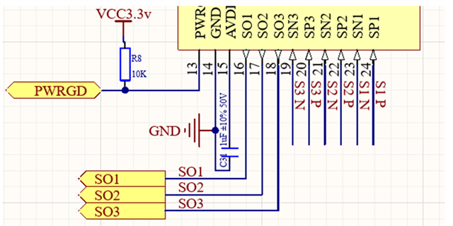

    The device is also reporting a AVDD under voltage fault. Can the customer check to ensure they are following the schematic recommendations listed on page 16 of the datasheet? The E2E post (+) DRV8353: Charge Pump undervoltage Fault - Motor drivers forum - Motor drivers - TI E2E support forums may provide some insight on their issue. Ensuring that capacitors are properly rated for the voltage may be a factor when dealing with charge pump errors. Generally, we like to use ceramic capacitors that are rated at twice the voltage they will be experiencing.
    Eli
  • Hi Eli,
    The following figure shows the information about the components surrounding the drv8305 chip in the design driver board schematic. VBat_D = PVDD = 12v, VCC3.3V = Vcc = 3.3V in the figure. C22 and C23 are rated for 50V nominal and should be fully adequate. Is there anything that can be improved?
    Thanks and regards,
    Cherry
  • Hi Cherry,
    Thank you for the schematic.
    PVDD_UVFL and VCPH_UVFL report errors for a short period of time when the fault occurred
    The cause of this issue will be C18 and C19.  They are rated for 16V when they are connected to VBat_D which will cause DC biasing. Due to this the effective capacitance of the capacitors will decrease, VCPH has an ABS_MAX rating of PVDD+12V so let's use a voltage rating for C18 and C19 that is double this (~50V). Please let me know if this solves your problem.
    Eli
