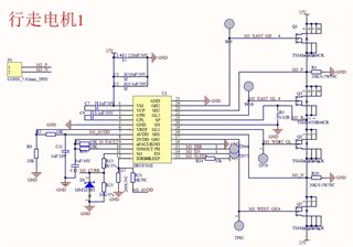

DRV8701: nFault disable when enter in sleep mode
Part Number: DRV8701
Hello Team,
The chip enter in sleep mode, and all inner function shunt off, this cause the VDD disable, and nither nFault. In our diagram, the nFault was connected to the DVDD,
Can we used the extern pull up power supplier for nFault? So that the chip enter in sleep mode, nfault still HIGH, when wake up, nfault keep HIGH, and only jump to LOW when OVP/OTP etc. occurred.
