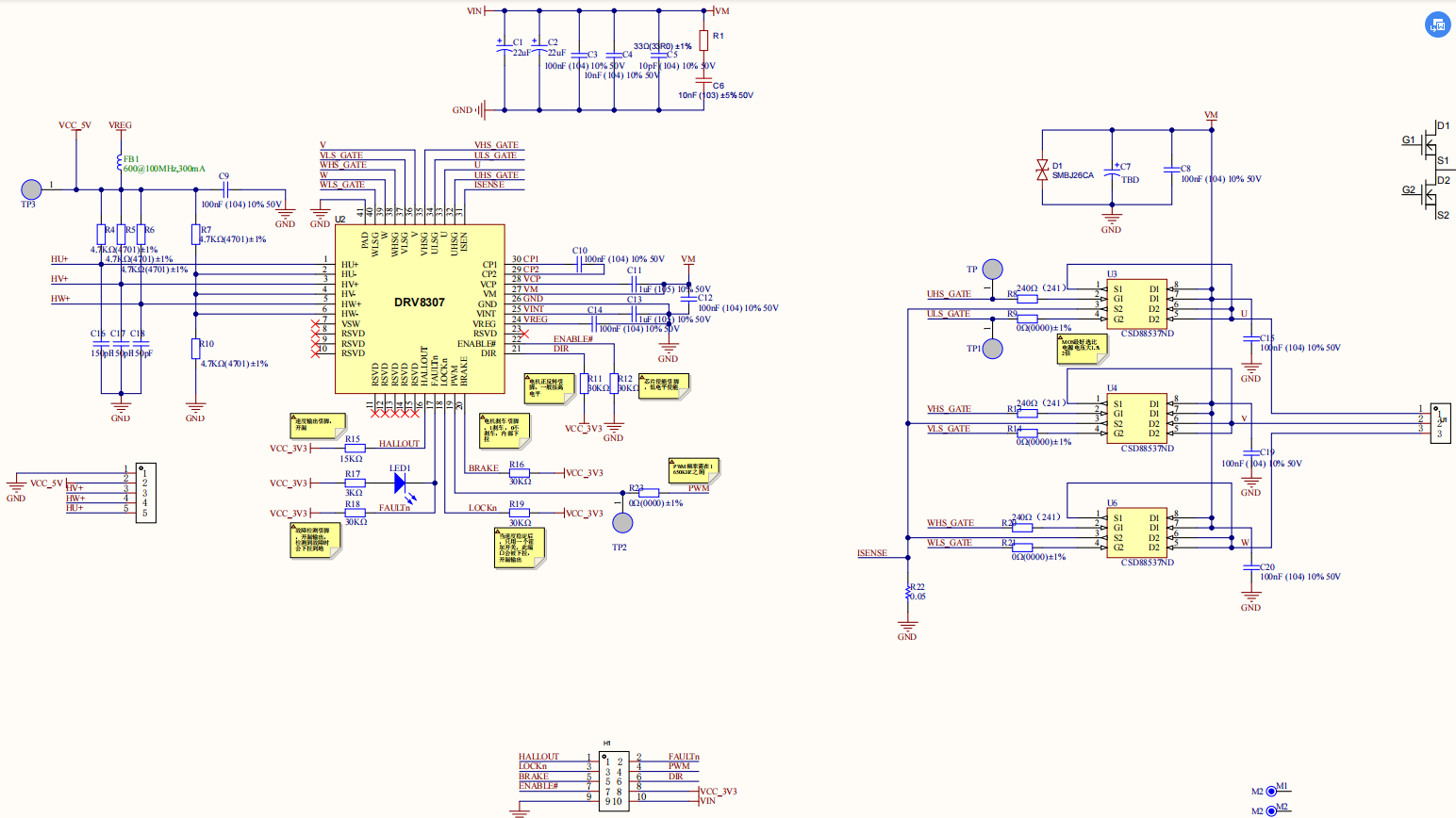

Hi Team,
ULS_GATE:
The motor cannot be started when the PWM duty ratio is lower than 20.
Attach the circuit diagram
Could you help to check it?
Annie

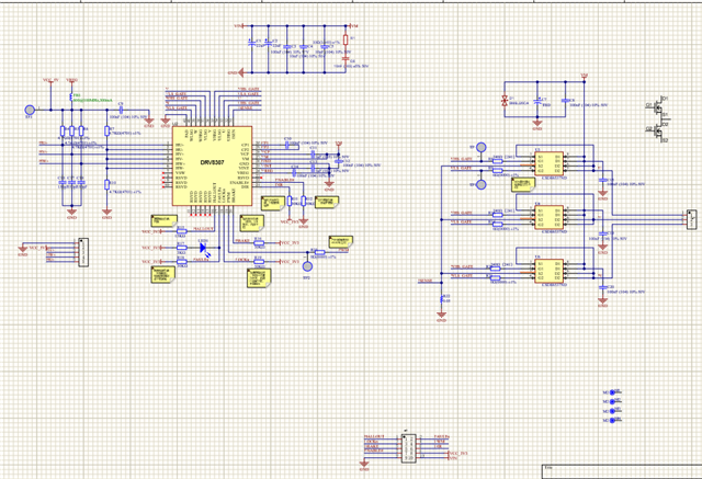

Hi Annie,
The schematic image is a little burry, could you provide a clearer version of the image?

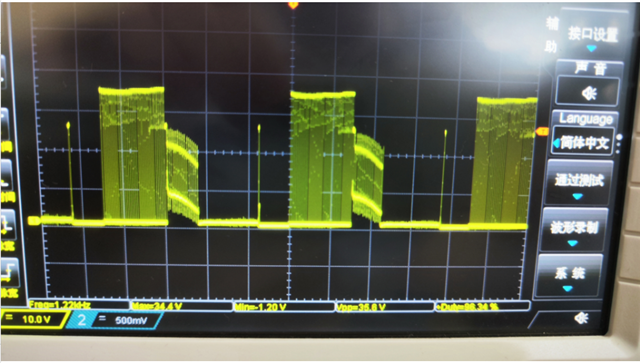

Hi Joshua,
Hall sensor input is normal. The DRV8307 chip has been replaced, and the waveform is consistent. The waveform is the same after the PCB has been changed several times.
Annie

Hi Annie,
Does the FAULTn pin go low when trying to drive the motor below 20% duty ratio?
There seems to be a spike on the high side gate signal before the gate is turned on. Could a capture containing xHSG, the phase voltage, and xLSG be provided?
In the schematic VM seems does not have a bulk capacitance of 47uF or larger as recommended in the datasheet, is the value for C7 greater than 47uF?
Joshua
