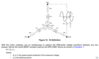

  • Hi Vishnu,
    Disabling mechanical and inductive AVS or adjusting the Kt value can solve this problem. But it will still report kt error at low speed. Customer wants to know how to measure the kt of the motor will be more accurate? The registers have been set to 2kt and 1/2kt.
    Annie
  • Refer to the below image to measure Kt. After measuring the Kt, program this value in the EEPROM and tune the lead time such that the estimated Kt (read back from register address 0x15 and 0x16) stays non zero. If you see Abnormal Kt fault getting triggered while the estimated Kt is non-zero, you can disable the abnormal Kt fault.
