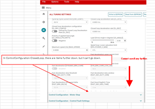

Evaluation is performed using the MCT8329A GUI. In ControlConfiguration-ClosedLoop, there are items further down, but I can't go down.
Is there any workaround? I had the same issue with both the latest GUI standalone and desktop.

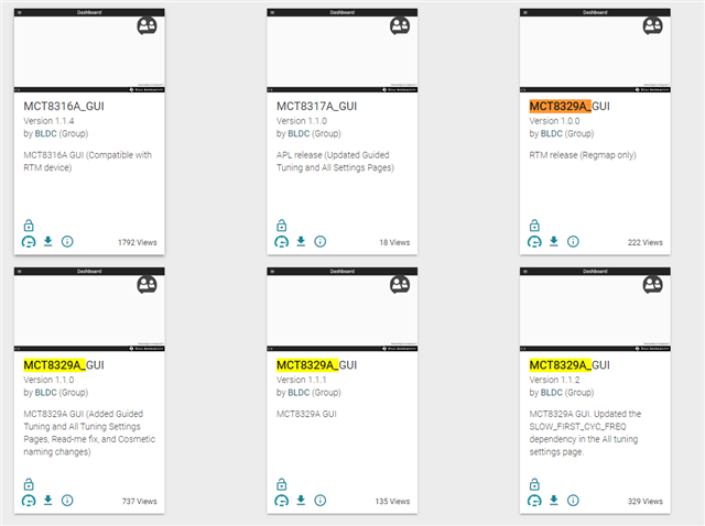

Hi Conor,
Thanks for reporting this bug. I've fixed this issue and published a newer version 1.1.3 of the GUI here:
https://dev.ti.com/gallery/info/BLDC/MCT8329A_GUI/ver/1.1.3/
Eric C.
