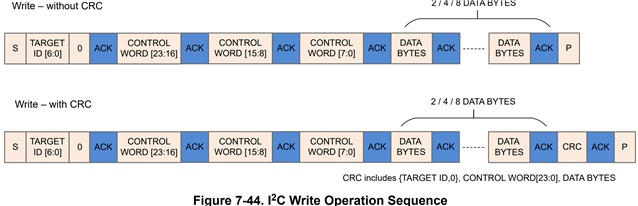

Hi team,
How long does it take to write the register setting on registers of MCT8329A?
Shunsuke Yamamoto
  • Hi Yamamoto-san,
    Today is a US holiday, so many of our team members are out of office currently, returning later this week - please anticipate a delayed response
    Andrew
  • Hi Yamamoto-san,
    Assuming you use the fastest specified I2C SCL frequency of 400 kHz, writing to a register follows the following sequence from the datasheet:
    The whole data word, without CRC, is 8 bytes, each followed by an ACK bit, totaling 72 bits, which corresponds to 72 clock cycles. For a 400 kHz clock, this comes out to 0.18 ms to write. However, there will most likely be other delays, so each transaction might be more like ~0.3 ms.
    All of the information about I2C for this device can be found in Section 7.6.2 of the datasheet.
