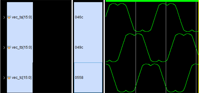

    The duty cycle of the three-phase PWM is as follows:
    (FPGA-emulated)
    Thanks and regards,
    Cherry

  • Hi Eli,
    The customer does not have closed loop control of the current.
    The SVPWM is calculated and given directly from the electrical angle. The electrical angle is an artificial accumulation of constant velocity, normally the magnetic field should change at a constant speed and the motor should spin at a constant speed. But now the motor does not spin at a constant speed.

  • Hi Annie
    Thank you for the reply. To clarify, since the driver is in 3x PWM mode I will need an image containing waveforms for INHA, INHB, and INHC. These should not be FPGA emulated. I will need oscilloscope readings because this will allow us to determine any faults in the design. I still need the motor parameters as well. Has the customer tested if this problem occurs when using a DRV8316 EVM to drive the motor? That will show us if there is a potential issue with how the DRV interacts with this motor. Could the customer also provide waveforms for OUTA, OUTB, and OUTC? The reason I am requesting so many waveforms is to determine how the driver is outputting information and if there are any issues how INHx is receiving inputs. I appreciate the customer's willingness to provide information thus far!
    Eli
