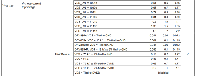

VDS (Pin 29) - trip current point - Vds > Imax * Rds(on) which for my case is - 100A * 4.4mOHM = 0.44 volts. So this pin should be given 4.4 volts.

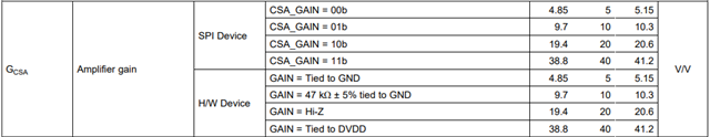

Gain (Pin 30) - gain settings - for my case - as vref is 3.3V, Rsense = 1.6mOHM, Imax is 100 amps, gain should be more than 20/20 v. So im going with a gain of 20/20.
It would be of great help if my assumptions are verified.
    For a VDS_OCP threshold > 0.44 V on the H/W version of this device you can set the value by connecting a 75kohm resistor to DVDD which will give you a typical threshold of 0.63V up to a max of 0.77V, meaning that it will trip a significant amount above the desired peak voltage/current limit (~143A) which may not be desirable for your use as it could never trip before damage occurs depending your components.
    That gain of 20/20 is correct for your values, and to choose the gain setting of 20/20 you can achieve this by simply connecting the gain pin to Hi-Z (>500k Ohm).
