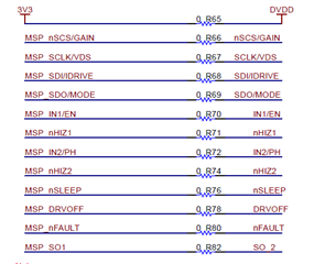

Hi team,
The customer use DRV8705S-Q1EVM to evaluate DRV8705 and they have an issue. They take all 0ohm resistor off  except for the R65 and use their MCU to control the DRV8705. And when the nsleep is low level, the GHx is low level, but when the nsleep is high level, the GHx is high level. And the customer even don't have any configuration.

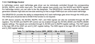

As the datasheet shows, there will be low level voltage when nHIZx is low level. And we test the nHIZx, it's low level. So we don't understand why the GHx is high level when the nsleep is high level. Could you explain it or do we have any other clues need to check?
