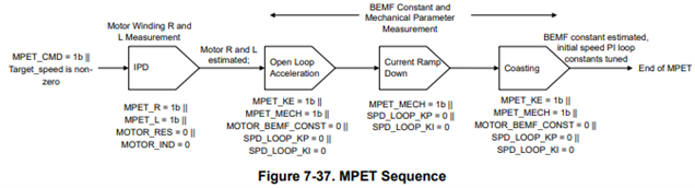

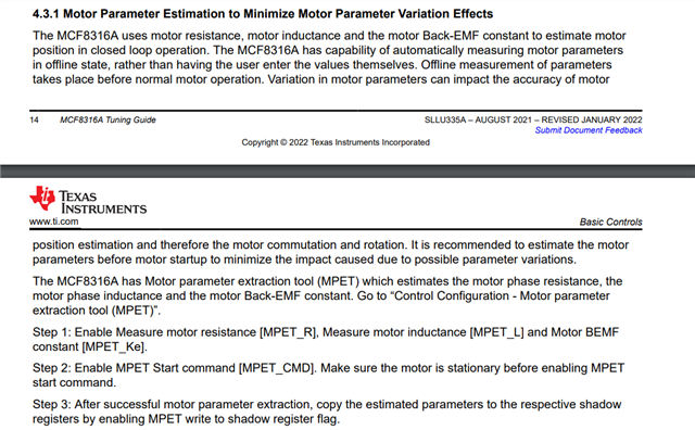

1) How to use MPET? The customer followed the steps in below figure for MPET auto-fetch. Could you help tell where can we see a reminder about the successful extraction? And how to write into the relevant registers?

  • Hi Cherry,
    For 1), MPET follows the logic in the following image:
    So, you can see that the steps the customer followed in Section 4.3.1 manually command MPET to start and go through each stage. Assuming that you are using the GUI, you can tell when MPET has finished to see if the relevant constants have nonzero values in the register map (such as MOTOR_RES and MOTOR_IND in the CLOSED_LOOP2 register). Also, the motor should stop spinning (if target speed is zero).
    To write the MPET values into the relevant registers, set MPET_WRITE_SHADOW in the ALGO_CTRL2 register to 1. To save these values so that they are present after power cycling, click "Write to EEPROM" afterwards.
