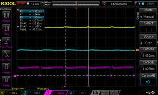

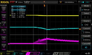

  • Hi Pablo,
    I am observing PWM activity at motor start (purple trace is motor current measured across the sense resistor). Note approximately 12ms PWM start time before it goes to full duty cycle. Second scope shot is expanded timescale of the first showing approximate PWM frequency.
    Pete
  • Hi Peter,
    Thank you for the waveforms. I have a better understanding of the problem now.
    There will be some delay as the PWM ramps up to 100% duty cycle. There can be many factors affecting this delay. But what you are seeing is within expected value. Is this delay a concern in your design?
