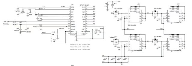

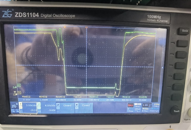

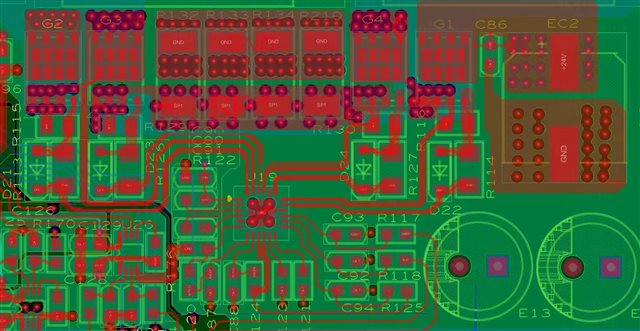

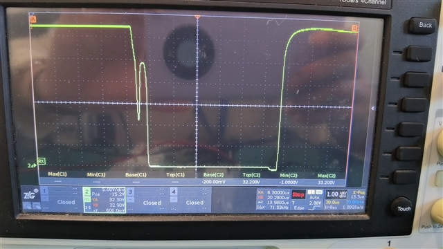

     The 8701GH PIN has negative overshoot to GND waveform, and the low level of Gh2 Gh1 pin has abnormal vibration after connecting the motor, the negative overshoot of the unconnected motor is -680 MV, connection motor negative overshoot-1.12 V exceeding specification-0.3 V below for test waveform
  any advise?thanks in advance
