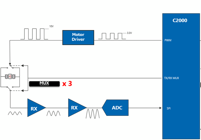

We are considering using a BLD motor driver for an ultrasonic flowmeter because  BLD motor driver is cheaper than a high-speed amplifier.
The BLD motor driver will input PWM (350kHz-3.3V) from the MCU, and the BLD motor driver will amplify it to 10V and output PWM to drive the transducer.
Can you please tell me which BLD motor drivers are available for the above use? We are asking because we cannot sort "Fsw" on the TI web to select a product.
