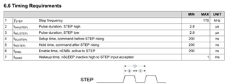

    Make sure your step signal follows the pulse duration set in 6.6 Timing Requirements, with a high and low time of at least 2.8us.

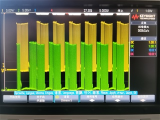

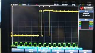

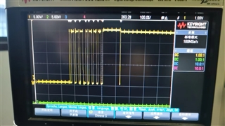

        The load of motor can't be unload, they test the Output of A&B, Can you determine the cause according to the waveform.
        locked,
    normal,
    Yellow is A+, blue is STEP
    Are these current waveforms? They do not appear to be 1/32 uSteps. Please send us the current waveform of the motor phase either A or B when you run the motor at 1k PPS and 10k PPS. Do you happen to have the motor datasheet? Specifically with speed vs. torque plots at various supply voltages? Do you use an acceleration profile to ramp up the speed in the application? Load inertia often times will not allow a stepper motor to spin if spun from 0 to 10k PPS with load.

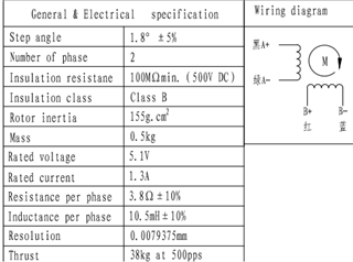

    Motor screen,
  • The motor appears to be a 3 amp max NEMA 23 motor - 57HBP56AL4 (2A 1.2NM) (link2)
       Do you think customer need use more load ability like DRV8452,
    That motor is large, but I think a DRV8825 should be able to drive it.  DRV8824 is probably too small to drive it reliably or quickly.

  • Thank you for the current waveforms!
    Give me another day to review these with a more experienced coworker and I'll get back to you.
    Jacob
    It looks like the Back EMF is dominating, causing our stepper motor driver to be unable to regulate current.  There are a few solutions to this:
    1. Higher voltage - try running at a higher voltage, like 36V and see if that helps.
    2. Slow down - perhaps add external mechanical mechanisms like gears so you can run the motor slower.
    3. Change the motor inductance (use a different model of motor).  Ask your motor supplier for a motor that is better suited to run at high speeds.
    4. Change to a unipolar motor - these are typically designed to run at lower torque but higher speeds.
