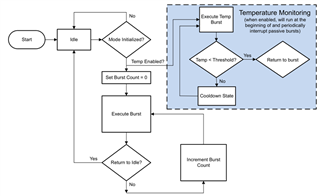

Below are the ULC operation modes described in the datasheet. What does "burst count” in this diagram indicate?

    Q2: In any cleaning sequence, you can have up to 30 bursts. Every burst has its own burst parameters including amplitude, start frequency, stop frequency, etc. For example, looking at the water cleaning mode in the GUI screen capture below, you can see that it has 4 bursts that need to be followed in sequential order to complete the cleaning sequence. The "burst count" in the state diagram is just saying that it will execute burst 0 first (Set Burst Count = 0), and increment up one until all bursts have been executed. So for water it will execute burst 0 (8), then burst 1 (9), then burst 2 (13), and finally burst 3 (14).
    If you would like to use the device without a PC, you will have to use a host that has the registers configured on it for calibration and cleaning sequences, and then a method of enabling the sequences. If you refer to our EVM, we have push button operation that does not require the use of a PC and uses the MSP430 as a host.
