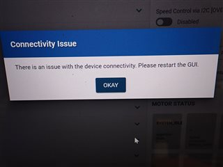

  • The GUI doesn't stay connected now.  I've restarted the GUI 8 times, the first 5 times is said "cannot connect to TI cloud agent".  The last 3 times it connects, but as soon as I attempt to change anything it says " There is an issue with device connectivity.  Please restart the GUI"   I restarted my Laptop twice. My internet connection is good. I'm dead in the water now.  My laptop in only 6 months old.
  • After several more restart attempts it complained about the run time engine not being install properly.  I uninstalled the run time engine and the GUI, reinstalled it, it still didn't work, then it complained about the not being able to connect to the "Ti cloud agent". I Restarted everything in this order: launch the GUI, plug in the USB, power up the DC bus of the EVM board.  Now it's working again.
