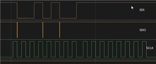

During the receiving of the SPI signals from motor driver. I am getting 0xC000, every time. On-board FAULT led is never lit high, which indicates that there is no fault the SDO value show that 0xC0 has fault and SPI error.
For the sake of SPI signals reference, I am attaching the SPI signals that are transmitted from MCU to motor driver.
nSCS pin is not the picture, but before nSCS pin is low when SCLK goes high and SCLK pin is low when nSCS goes high.

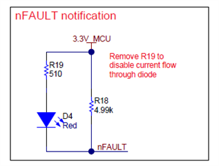

    Thanks for posting in this forum. You mentioned "On-board FAULT led is never lit high". Please see the below snippet from the schematic. Was 3.3V_MCU available at the time of your testing? This supply will be present only when the USB is connected. Otherwise the nFAULT LED will not light even if there is a fault condition. Also for this open drain pin a pullup is required which on the EVM is R18 shown in the snippet.

    "2. To rotate the motor a single step (18 degree, in this stepper motor case). I am sending 0x0A and 0xFA (for CTRL3 register) (sending 1-byte at a time as SPI buffer is of 8 bit for this MCU).".
    You can send one byte at a time but the nSCS pin must not go HIGH until both bytes have been transmitted. See page-40 of the datasheet.
    0x0A and 0xFA is not the correct sequence. Looks like you are using 1/256 uSteps which means your stepper motor will not move by 1-step it will move by 1/256 step/ To move by single step use full-step mode. CTRL3 address is 0x05. Use the following sequence to move the motor by one full-step:

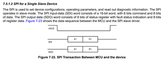

    Since, the CTRL3 register address is 0x05, so shouldn't we sent 0x0A in the address down below.
    as, A0=1, A1=0, A2=1, so the A1 byte comes out be 0x0A not 0x05, as B8 is 0.

    I see. You wrote the final assembled values in your email. So 0x05 address write will be 0x0A (rotate left one position) for the first byte with W0 = 0.. You are correct. The SPI transmission sequence should be 0x0A, 0x30 and 0x0A, 0x70.
    "But, for fine tuning of the motor, I want to drive the drive the motor in the micro-stepping mode. For that, I changes the values for CTRL3 register to 0x3A for sending SPI=0 low pulse and 0x7A for SPI=1 pulse. So after sending the 256 time, these data bytes (0x0A, 0x3A and 0x0A, 0x7A), the motor did rotate smooth to 18 degree, which is 1 step of the motor". This is the correct method for running with 256 uSteps.
