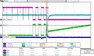

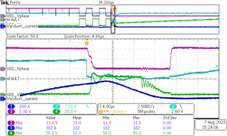

Customer made a short circuit between phase U and phase W by a short wire cable to make over current event.
Device:DRV8350HRTVR (HW version)
Detection Threshold is set as 0.7V by 75KOhm.
here are some questions.
- When nFAULT pin is pulled low after short-circuit event, why the PWM signal is pulled low immediately, but after 15uS, the PWM is active high, and then always low. Why?
- What is the response time to turn off the PWM signal, when nFAULT is pulled low? is it specified in d/s?
