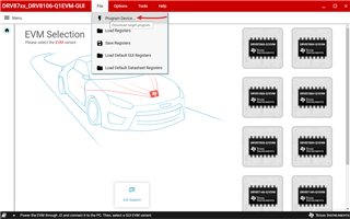

  • Hi Jie,
    Why do you want to open the CCS project? The firmware can be updated using the "File > Program Device" menu after connecting a MSP-FET to the EVM. This is our suggested method to update the firmware to match the GUI's firmware requirements.
    Another option is to use the .out or .txt file from the firmware zip file and program the EVM using UniFlash, https://dev.ti.com/uniflash. As for the CCS project it was built with CCS 9.3. You may have to create a new CCS project for CCS12. But you won't have to unless you want to edit the program to customize it.
    That all said, based on the fact the EVM was sampled two weeks ago it would not require any firmware change for functionality. Let me know if any questions.
