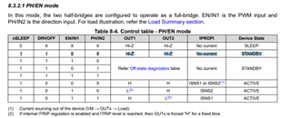

I would like to check with you if DRV8245 HW variant have Hi-Z state or not? Customer tried to pull up the DRVOFF pin to enter Hi-Z state in our EVM according to the control table below.
But DRV8245 cannot enter Hi-Z state correctly. I saw HW variant cannot support Hi-Z state in PWM and independent mode. So would like to check with you on this point.
