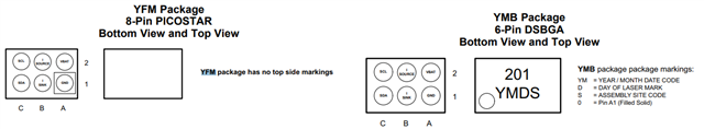

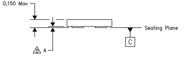

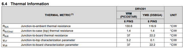

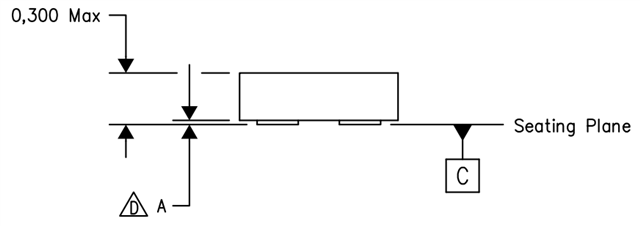

DRV201: what differencts of DRV201YFMR and DRV201YMBR?
Part Number: DRV201
