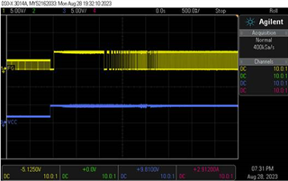

My customer tested DRV10964 and found some problems here.
Could you tell me why FG will delay after VCC turn on? thanks

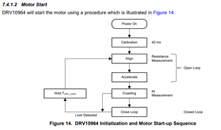

Hi Jimmy,
After power-on, DRV10964 runs calibration for 40 ms and aligns the rotor to a known position. This is done because DRV10964 is a Sensorless device and it does not know the initial position of the rotor. During the calibration and align phase, motor will not spin. FG will start toggling only when the motor starts to spin in open loop. See the Motor start sequence shown below.
Vishnu
Hi Vishnu,
I would like know what timing is? Due to customer measure 1S during this time. It's too long.
Jimmy,
Here's the split-up for the 1 sec startup time. Unfortunately, this time is fixed in the device and cannot be modified.
Calibration time - 40 ms
Align ramp time - 300 ms
Align time - 640 ms
Vishnu
