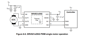

Hello Community,
To operate the valve, I'm using the DRV 8210 DSG. I'm generating PWM1 (TB0.1) and PWM2 (TB0.4) from the MSP430FR6043. By using ADC I am sensing the supply voltage Vs to achieve the required dc to run the motor.
        i,e DC= (5 (required voltage) / Vs)* 100;
For PWM Mode, I connected the MODE to GND in Driver.
1. I verified the PWM generation at the MCU end; a) IN1 = 0 and IN2 = 1 (PWM) (Reverse); b) IN1 = 1 (PWM) and IN2 = 0 (Forward).
2. Next, I connect the MCU's PWM1 and PWM2 pins to the driver IN1 and IN2 ports. I checked the output from OUT1 and OUT2 and it is as expected.
                 a) OUT1 =Low and OUT2=PWM (Reverse)
                 b) OUT1=PWM and OUT2=Low (Forward)
A channel =OUT1 and B channel =OUT2

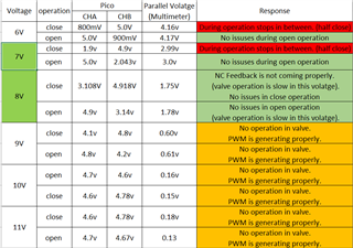

3. When I connect the motor to OUT1 and OUT2, let's assume I'm doing reverse operation, OUT1 = PWM (75% DC) and OUT2 = PWM (25% DC), it appears to be in complimentary mode.why?
I conducted the Test with various voltage, for some voltage the parallel voltage at OUT1 and OUT2 is 0. i,e (close) Vs=9V OUT1 =4.1v and OUT2=4.8v.
Please look the below table for your reference,
PWM generation from the MCU end is happening as predicted, however after I connect the motor to the DRV, the issues listed above start to occur.

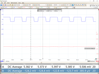

    1.When I set the non-switching input to HIGH and inverse the duty cycle of the switching input, the output voltage from the driver (OUT1 and OUT2) varies like (3 v to 11V) but I want constant 5v. By adjusting the PWM duty cycle, I want to manage my driver's output voltage so that it delivers a consistent 5 volts to my motor. This method not worked as per my requirement.
    2.When I set the non-switching input to LOW and inverse the duty cycle of the switching input, the output voltage from the driver (OUT1 and OUT2) is  constant 5v. So I am fixing this set up.

    I am using a CWX Mini Motorised valve with an operating voltage range of 3V to 6V. The motor is running at 6 volts and 7 volts, but the output terminal voltage difference is less than the required level of 5 volts, therefore the valve opens and closes slowly, but it works.
    However, if I raise the voltage over 9 volts, the motor stops since there is no voltage difference at the output terminal. Please refer to the excel sheet table that has been attached above.

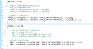

    Every 1ms, I read the adc data and load the compare value for Timer_B.
