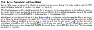

    The slopes you highlighted are likely when the device outputs are in high impedance mode, like in the fast-decay mode during Mixed Decay mode.

    Based on your comments and datasheet explanation on "7.3.5 Current Recirculation and Decay Mode", I and my customer checked more about the waveform highlighted above.

    I think the difference is from whether the driver detected a current beyond the chopping current threshold and decided it needs to hit fast or slow decay mode.

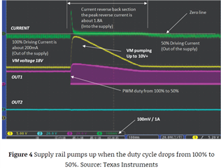

    For your bottom right scope capture, see Figure 4 Supply rail pumps up when the duty cycle drops from 100% to 50% in the article Tips and tricks for testing, debugging brushed DC motors.  Same in your figure - sudden reduction in duty cycle (from 100% to 0%) causes the supply voltage to be pumped up by the inertia and speed of the motor that is still spinning.
    Is there any specific issue you're having with the motor when you're seeing these waveforms that you're trying to debug?

    For my capture on the bottom right side, I tried to capture the reverse currents as you mentioned earlier in the post, and also zoomed the waveform but it doesn't see any reverse currents. I captured currents at one of the connector wire which is connected to the motor.
    I don't think I understood right or not so I would like to clarify your comments above.
    Do you mean the waveform in the left side one? Because left capture has very thin currents slope when VIN2 is transit to 0. But right side waveform does not show any reverse currents.
    Please refer that above bottom images are 200us/div where as yours are 100ms/div.
    They said the motor shows 2~3 degrees difference(ahead?) than normal and think it could cause the mechanic damage.

    The waveforms show where it's switching from fast decay to slow decay.  The current spike in the second image is the current freewheeling through the body diode.
    How much is your bulk capacitance?  And can you try to compare on an EVM so we can see if it could be related to your PCB schematic/layout?
    Jacob
  • Hey Ernest,
    Ahh apologies I didn't see that you had disabled current regulation.  I talked to my manager and he said that the spike you're seeing in the first picture is from the current that remains in the coil when you switch the inputs.  Then you don't see it in the second image because at that time there wasn't excess current remaining in the coil. So there is no chopping going on, the device outputs are following your inputs.
