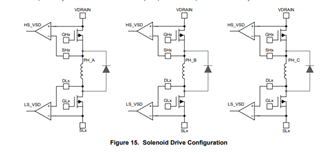

When operating the DRV8343-Q1 in solenoid configuration and using PWM.
Is there a preference between leaving the HS fet on and PWMing the lowside fet or leaving the lowside FET on and PWMing the highside one?

Hey David,
There should be any major advantage/disadvantage between either option.
Please check out this resource from TI if you haven't already for more info on this topic.
https://www.ti.com/lit/an/slvae59a/slvae59a.pdf
