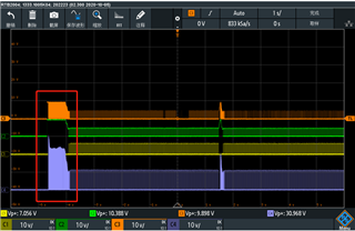

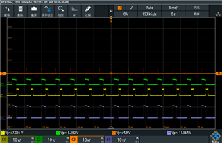

Recently, one of our DRV8701 chips failed, and the four gate output control voltages were abnormal.
The phenomenon is that the output voltage without load is normal, and the load ON the chip will stop at once, reporting fault errors.
pic1 is nomal waveforms, and pic2 is abnomal. Could you pls tell me how to debug this phenomenon? Thanks!
pic1
pic2

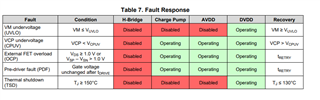

    3) Can you check what kind of fault it is by checking what is operating and disabled based on this table

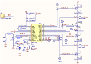

  • (1)The driving load is a DC brush motor.
    (2)The MOS model we use is TSM045NB06CR, with a VDS of 60V and ID of 16A (TA=25 ℃). We set the IDRIVE pin according to the schematic shown in Figure 1.
    (3)We checked the AVDD pin is operating.
    Fig1: the Driver portion of our schematic

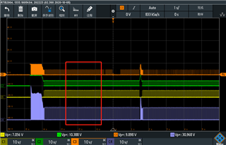

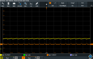

    Fig2: EN and Fault pins during motor drive(EN-orange,Fault-yellow)

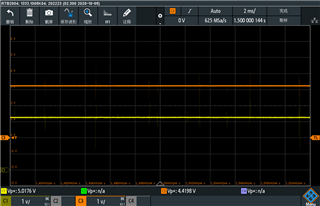

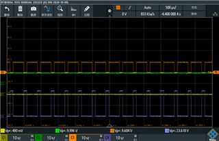

    Fig3: EN and Fault pin when unloaded(No motor connected)
    (We have replaced other motors, so we can eliminate the fault on the motor)
                                             Fig1
                                           Fig2
                                             Fig3
  • Hi Han,
    It looks like either and OCP or PDF event.
    Can you confirm the retry time is 2 ms. Can you also try increasing IDrive to either the 200 mA option and the capture the Vds and the Vsp voltage waveforms.

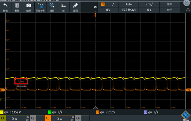

  • Hi Keerthi,
    I don't konw how to  check the retry time.
    Our IDRIVE pin is suspended and there is no resistance connected.
    We captured the waveform of VDS.
    (VM-yellow,SH1-orange)
    It seems that VM-SH1>1V.

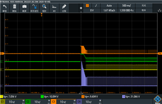

  • Hi Keerthi,
    This is the gate waveform.
    C1/C2/C3/C4 correspond to Q9/Q10/Q11/Q12 in the schematic.

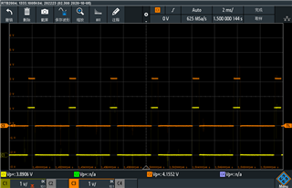

    The following is the VCP waveform.
    The following is the corrected VM&SH1 waveform.
    Could you determine the cause of DRV8701 fault based on these waveforms?
  • Hello Zeming.
    Can you try increasing your VM to a higher value and looks like Vm dips below the UVLO threshold. The charge pump is not operational, which is the case when you have an UVLO fault:

  • The voltage of VM is pulled down during driving.What external reasons can cause VM voltage to decrease?
  • Hello Han,
    How are you providing VM. Is there some sort of current limit that you have set on the VM source, or can it handle the current demands of the system?
    Keerthi
  • Hi Keerthi,
    We used battery to provide the VM and replaced battery with different ones to ensure that the batteries were functioning properly.
    When starting to drive, the VM voltage is pulled down to 6V. Under normal conditions, it is 20V.
