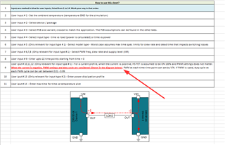

I have a question. How can I calculate thermal under PWM setting? Even if I changed slew rate and duty cycle, the thermal doesn't look changed.

You're using the Half Bridge Driver Junction Temperature Estimator Excel spreadsheet tool, correct?
It looks like the PWM duty cycle thermals only change if you set the current to a negative value. I'm asking a coworker whether this was on purpose or not, but in the meantime you can run your estimators with a negative current value and desired PWM and it should work for you.

Yes, this is on purpose. See the HowToUse sheet in the Excel tool for a nice diagram of positive vs negative current and our device. The High-Side FET is assumed to be ON 100% of the time, so the PWM setting doesn't matter for positive current.

Thank you for checking. Yes I use that. The low side Rds_on is the same as the high sides. So, even when the HS FET is PWM'ed in the real application, we can get the same thermal result by using negative current. Is my understanding correct?
Shoji
Yes, that is correct! It will work out to the same thermal result across all the FETs.
