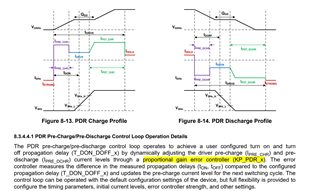

I got some customer questions.
1. Does this min/max range contains the product variation?
2. Does this internal clock reference only SPI clock regardless changing the register?
3. To clear WD, do we need to  keep inverting "WDT_RST" to the previously written value, such as 1, 0, 1, 0?
4. What does KP_PDR factor mean and what is the function of that?

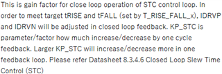

6. What does KP_STC factor mean and what is the function of that?

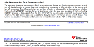

7. What does DCC factor mean and what is the function of that?
